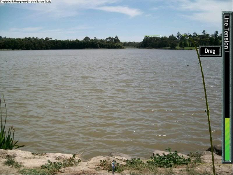

4)I attached a picture where you can see the flyline goes past the water horizon and into the sky? More careful work needed here to define the boundary of the water so the fish doesn't take off into the sky like a light plane.LOL

Other than that, very impressive first effort and also very intuitive as an outing maker. I like the views of the water, almost like the eye view of the angler himself. I started fishing this outing with a light rod and 5x leader and I was surprised to hook a good size rainbow that took me all the way to the backing, went across the lake and into the sky!! I managed to retrieve some line after a while and landed this nice fish. Used a size 18 grey midge dry fly.
