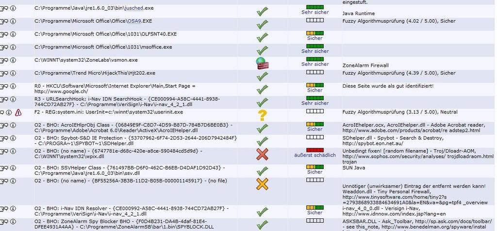

Download HijackThis:
http://www.trendsecure.com/portal/en-US ... s/download
install it
run the prog
click on " do a scan and save a logfile"
DO NOT CLICK on "FIX checked" - you only want to examin at this step
copy the logfile into this window:
http://www.hijackthis.de/en
if you see green hooks only, your system seems to be malware free
if you have red exclamation marks, you should go to there: ( in this case the pros should continue)
http://forum.hijackthis.de/index.php?langid=4
use the subcategory "english help"
PostPosted: Wed Feb 06, 2008 7:38 am
by taupo_tiger
this is how the analysis looks like then:
