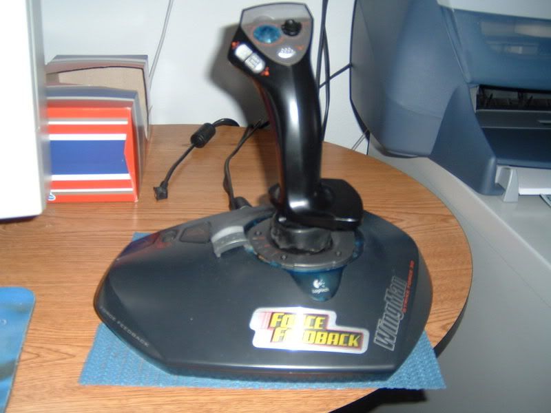

PostPosted: Sun Feb 25, 2007 4:37 pm
by kerrye
Don't know shanksi. This is the logitech I'm using and I will play with the settings to see if I can duplicate your problem and get back to you. KE
PostPosted: Sun Feb 25, 2007 4:42 pm
by shanksi
Thanks Kerry that looks similar to my joystick.
shanksi
PostPosted: Sun Feb 25, 2007 5:02 pm
by kerrye
OK;
Game settings (RWFF) Joystick on
Feedback 0n
Wingman settings Overall effects 127%
Spring effect 101%
Damper effect 73%
Enable Centering Spring
Centering Spring Strength 57%
This is the way I am playing it and it is working pretty well. I could go up some on the overall effects setting. (I think)
PostPosted: Sun Feb 25, 2007 7:07 pm
by shanksi
Thanks Kerry discovered from your settings that the disc that we got with the game was out of date. Didn't have either spring effect or damper effect but have now downloaded from Logitec website and force feedback is now working. Will try different settings to find best suitable as force feedback not too strong. Thanks again for all your help.
